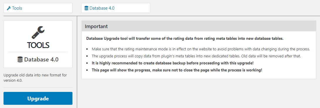

The upgrade process is very simple, and it should be done as soon as possible. Simply click the Database Upgrade button, and you will be taken to the Database 4.0 upgrade tools panel. This is a very simple panel that has only one button to start the process. Make sure you read the important notices and make sure that you have database backup ready in case something unexpected happens during the upgrade process!
Upgrade Panel
Upgrade Panel
The process requires the upgrade screen to remain active. It will display the upgrade process progress, and it is controlled by this page. the upgrade process is split into various smaller steps for each rating method, all upgrades are pure SQL queries, so they should be done quickly, and they should not take too much time even with a large number of ratings and votes.
