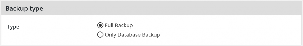

To be sure that the website is restored properly, you need to create a full backup on standard (no multisite) WordPress website (database and files), and you need to use the proper version of GD Press Tools Pro for creating a backup: backups made with plugin versions older then the restore script can’t be restored!
Full Backup Option
Full Backup Option

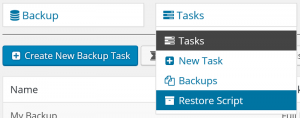

Once you have the backup file, you need the restore the script too. To get this script, open the Backup plugin panel, and open the second dropdown to get the Restore Script panel. From this panel, you can download the ‘gd-restore-backup.php’ file.
This file is located in the plugin archive in the addons/backup/restore folder if you want to get it from the plugin archive.Step 2:
