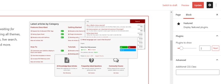

Detail from the Featured block created for new Dev4Press website

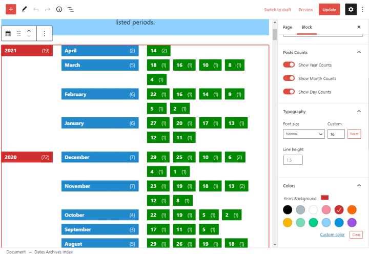

What I have learned so far can be seen as a practical implementation of 3 blocks in the ArchivesPress plugin where all the existing shortcode attributes have been converted to block settings. More about the latest version of the plugin is available in this block post.
Block with sidebar settings controls from the ArchivesPress plugin
