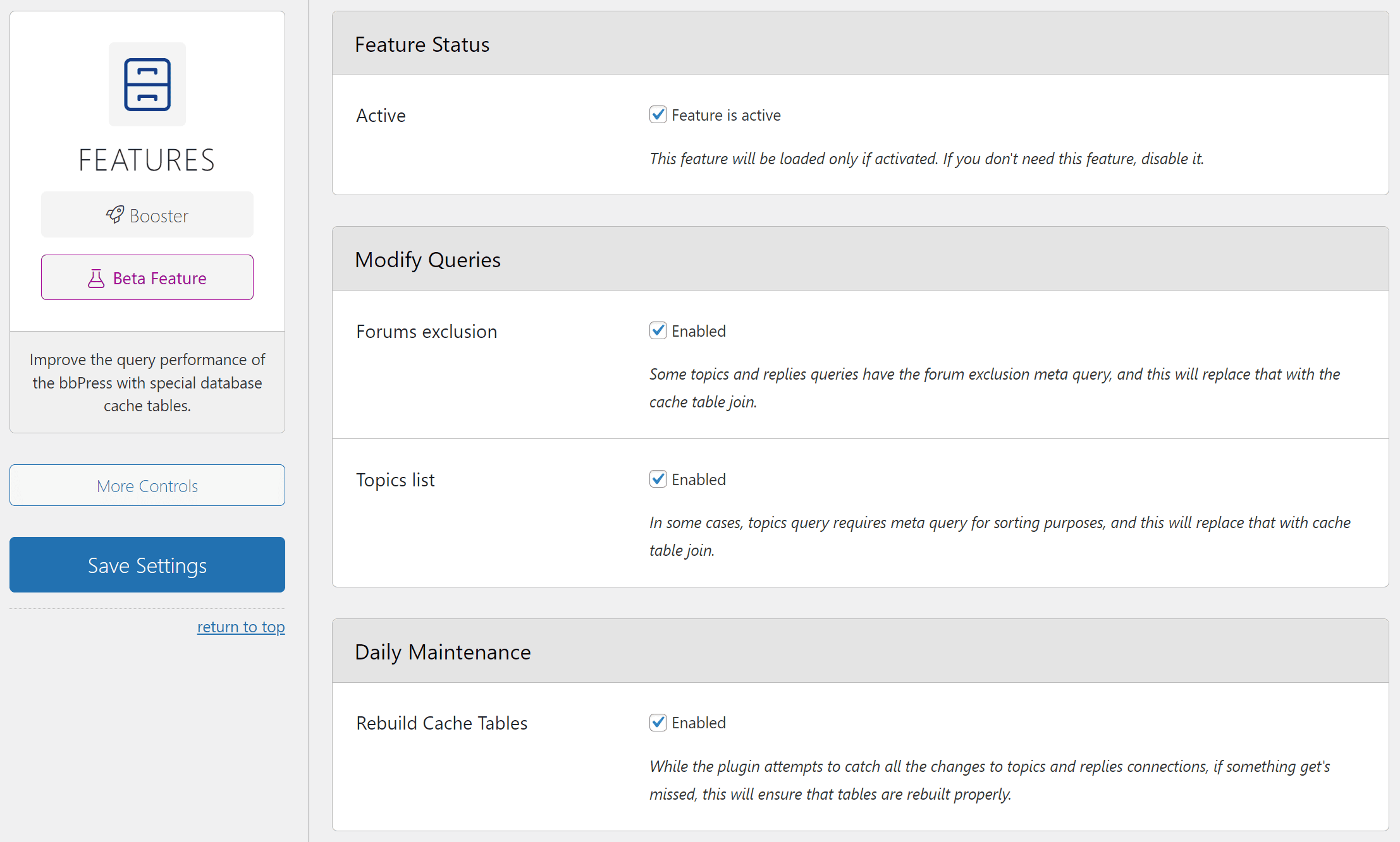

Booster Settings
The other way Booster is used is by directly replacing queries used by GD bbPress Toolbox Pro features. Plugin has ‘Classic’ and ‘Boosted’ query generators for comparable queries. If the Booster is inactive, Classic queries will be run (these depend on the postmeta table); if the Booster is active, Booster queries will be run instead.
You can stop using Booster at any time, and you will not lose any data; any time you want to use it, you must make sure you run the process to rebuild the index tables. Currently, Booster settings have few controls, but that will be expanded in the future for more control. The supported queries for GD bbPress Toolbox Pro features are always boosted; if the Booster is active, there are no options to control that. More settings are coming in the future versions, and more postmeta data will be mirrored inside the index tables.

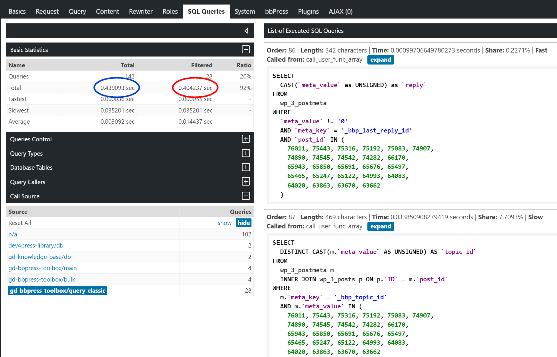

This first example is for this page: https://support.dev4press.com/forums/forum/general/issues-tracking/. This example shows Booster’s optimization for the page, where 28 queries can be optimized.
Booster is OFF
Booster is Inactive.
28 Queries are affected and run through the Classic query generator. It takes 0.4 seconds to run those queries, which takes 92% of the total query time for this page.
Booster is ON
Booster is now ACTIVE.
With Booster active, these 28 queries are run through the Booster query generator. And it takes only 0.0019 seconds to run those queries, or only 5% of the total query time for this page!
This is quite a change, and the query time goes from 0.4 seconds down to 0.0019 seconds, which is 99% faster!

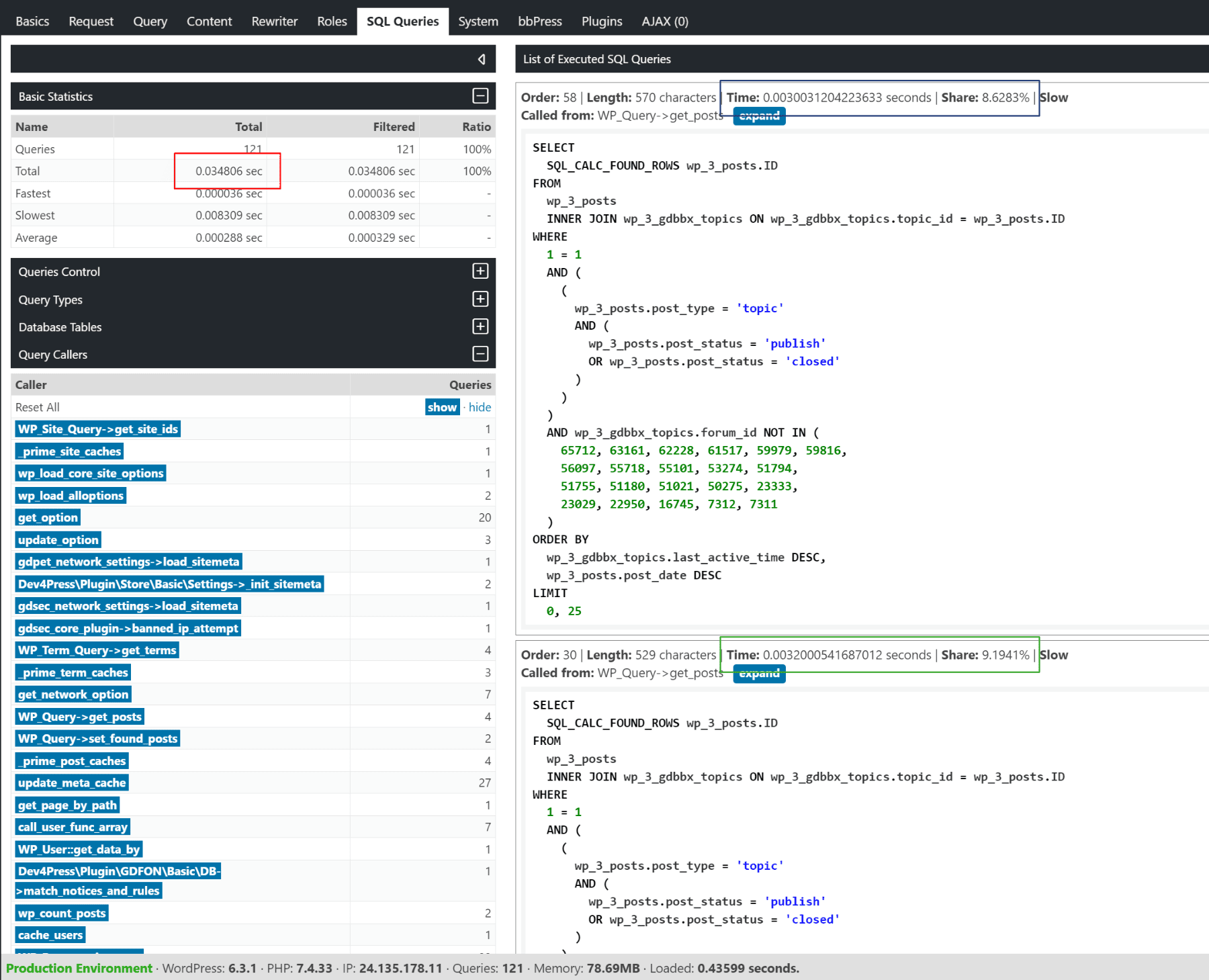

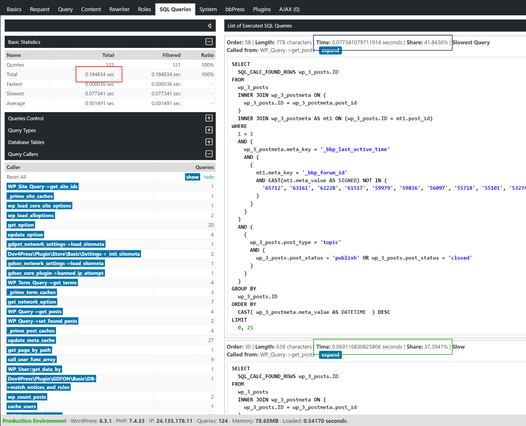

The second example is for this page: https://support.dev4press.com/topics/. This is the page listing all the topics by last activity time. We are showing this page for logged-out users (or visitors) because it demonstrates two things: replacing the ordering part of the query from postmeta to the index table and replacing filtering out of the private and hidden forums from the query from postmeta to the index table. The focus is on the main bbPress query used to generate this page results.
Booster is OFF
The 2 main queries used by WordPress and bbPress take 0.14645 seconds and take almost 80% of total page SQL time.
Booster is ON
With Booster active, these 2 queries take 0.0062 seconds; this time, they take only 18% of total page SQL time.
But, there are actually 2 queries, quite similar, run by the WordPress and bbPress here. WordPress runs the first one before bbPress has started rendering – this is the main page query, and this one only filters out forums. But, again, where the bbPress takes over, it runs a second query, similar to the first, but now with the ordering by the last activity. This is how bbPress works; the main query is executed twice on almost every page.
As you can see, without Booster, the page needs 0.184 seconds to run all the queries. After the Booster activation, that time goes down to 0.035 seconds. That is 80% faster!

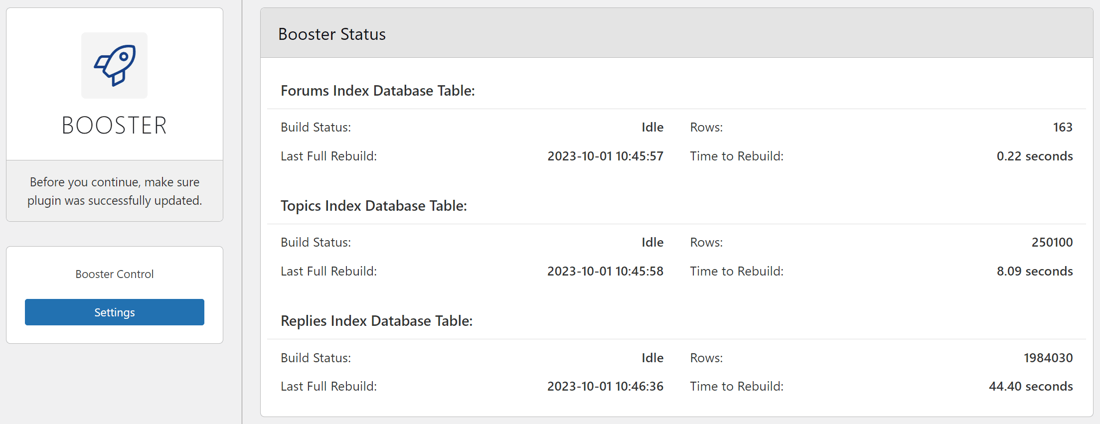

Well, there are two downsides. But both are small sacrifices for the huge performance gains they will provide you. The first one is the existence of the duplicated data. A lot of data in postmeta tables will need to be copied into dedicated index tables. For the website with 10 GB of data taken by postmeta and the posts table (and about 2 million topics and replies), the index for the forums, topics, and replies will take about 300 MB. That is about 3% of the extra space needed. For the Dev4Press Support forum, with about 15000 posts in the forum, index tables are only 1.5 MB (or 4% of the total postmeta and posts tables). Not much.
The other downside is that whenever a forum, topic, or reply is created or updated, Booster needs to run a few additional queries to update the index for the affected posts. BbPress typically needs to run about 15 to 20 queries to create a topic (and update many other things), and Booster will add up to 4 (very fast) queries to update the index. The booster will add about 10% in query time when measured in the actual time needed. And again, considering the benefits, there is not much overhead, and it is not a big deal.
Booster Statistics panel
