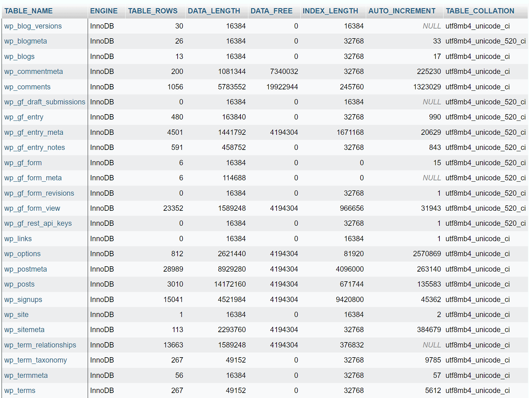

So, here is the image showing the snapshot of all tables in scope for this cleanup, with information about size, index, free space, and more. But first, the overview of the data affected by the cleanup:
  • Total number of rows: 158,771 Rows
  • Total data size: 54.85 MB
  • Total index size: 26.04 MB
  • Total data+index size: 80.89 MB
Snapshot from phpMyAdmin for tables targeted in the cleanup

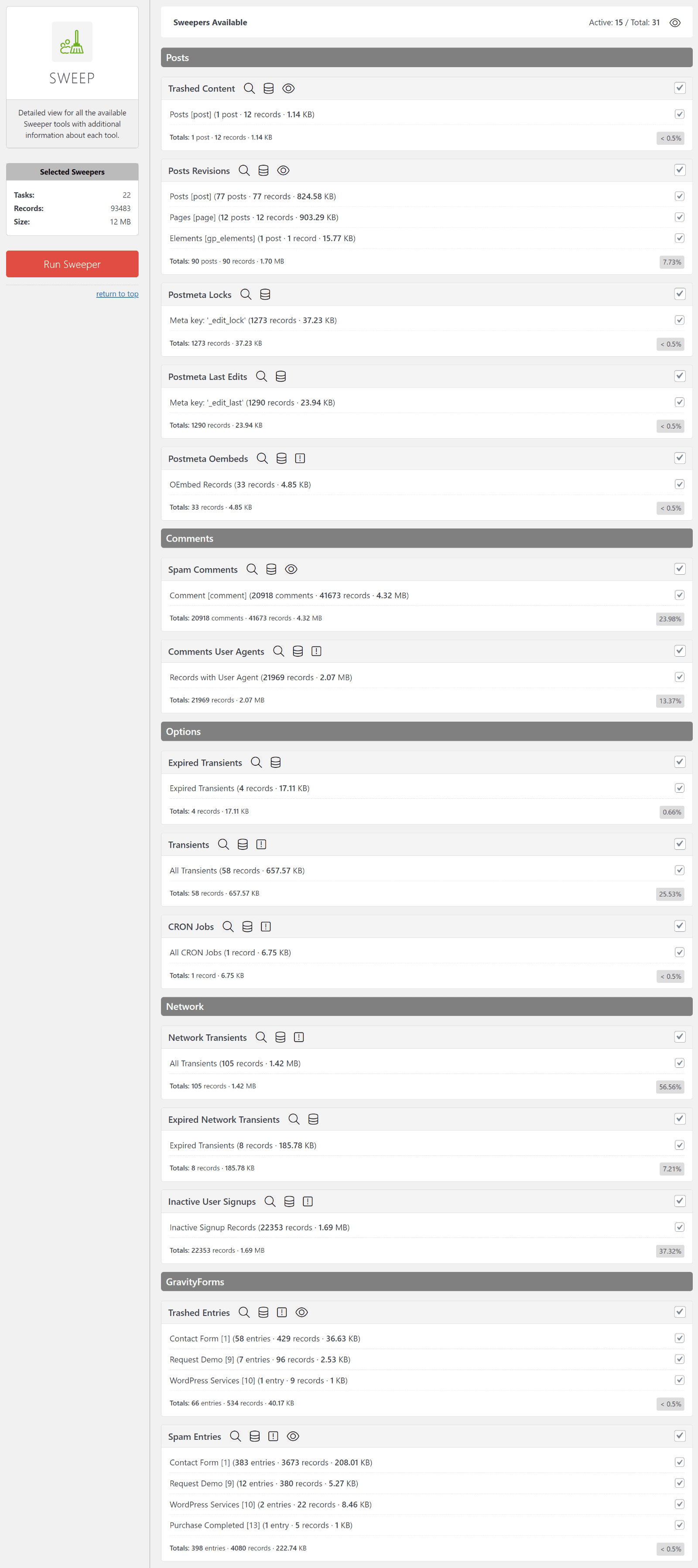

SweepPress Pro Estimates

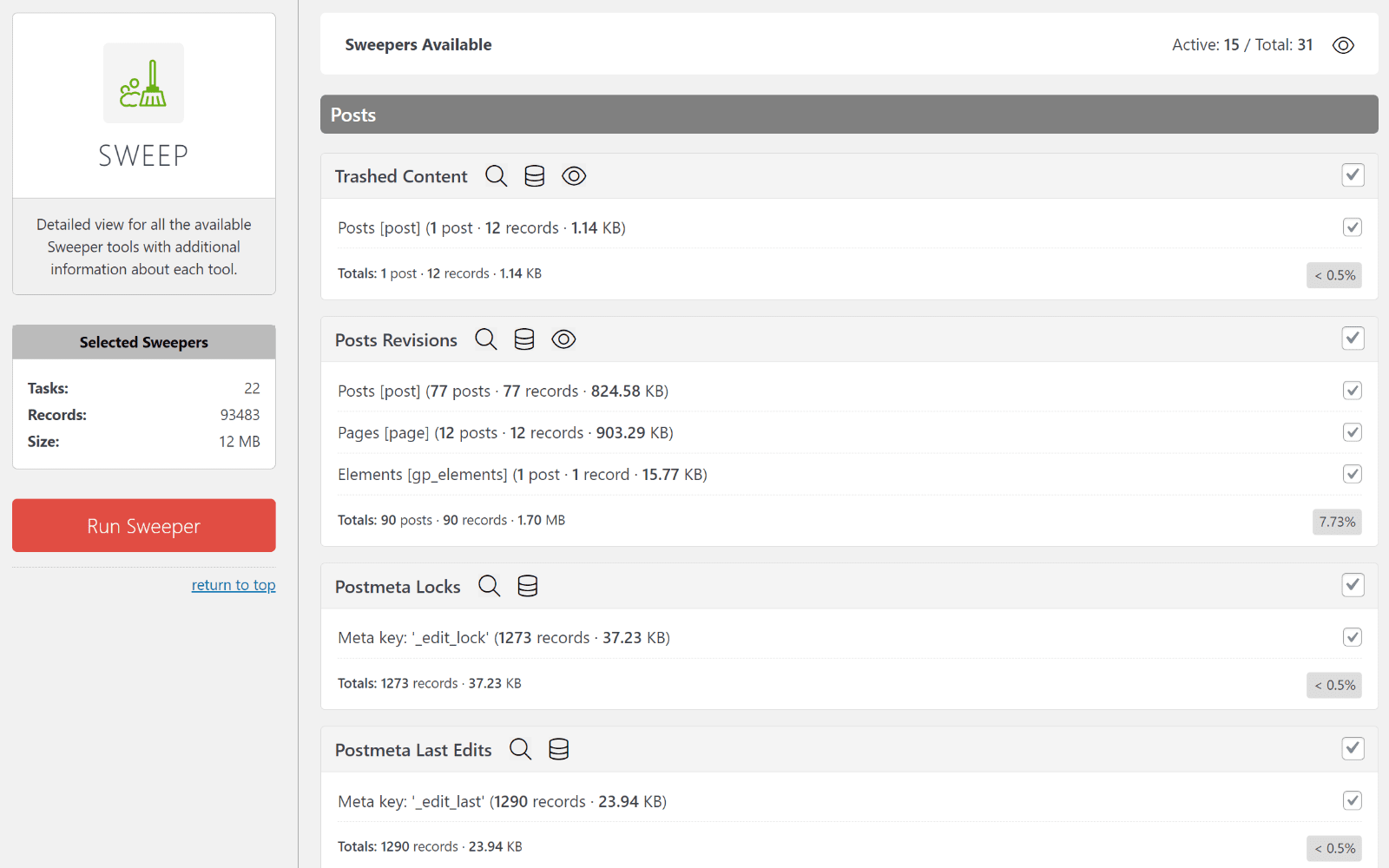

Now, opening SweepPress Pro, and here is the full overview of what can be removed from the database. A total of 15 sweepers reported some data to remove. But, what is important to note, is the total size of 12MB to remove and close to 94000 records.
SweepPress Sweep Setup (click to see the full image)
Here comes the important part. The total number of records affected tables have is close to 159000, and the sweeper reports close to 94000 to remove?! This is not quite correct. These estimates show a number of AFFECTED records across multiple tables, but not all sweepers are removing whole records; some sweepers are only removing data from the database record/row, but not the actual record/row. An example of this is the Comments User Agent sweeper that will only remove data from the User Agent column in the Comments table, but it will not remove whole comment rows.
Also, in this case, Comments sweepers overlap, with Comments Spam sweeper and Comments User Agent having a partial overlap of data they are going to work on. So, the total data recovered by these two sweepers is not going to be the sum of the data estimated for individual sweepers but is close to that total estimate.

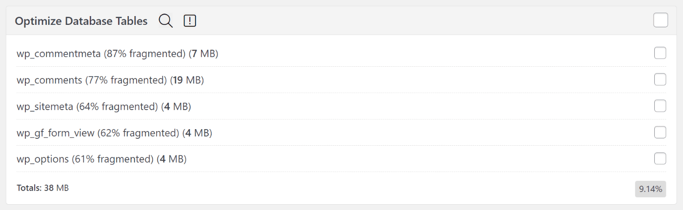

Please, notice that the Free space column (DATA_FREE) in the Database, after the snapshot, has increased in size for some of the tables because, after the deletion of records, the table data and index are lower, but the free space increases due to fragmentation. Defragmentation is an expensive operation that MySQL doesn’t run on its own because the only way to restore that free space is by optimizing the table by removing and recreating it again, and that can be slow, so it is not advisable to run often.
Here is where the Optimize Tables Sweeper comes to help. This sweeper is made to run the optimization that attempts to recover free space that is still allocated by the server due to fragmentation. And because of how that is done, it is highly recommended to avoid running this sweeper too often, only after removing a lot of other data and if the threshold for the optimization is reached. In the plugin settings, you can set the fragmentation threshold for this sweeper, and only heavily fragmented tables will be taken into account.
Optimize Tables sweeper analysis.
Now, if you run this, the plugin will ATTEMPT to optimize these tables. But, there is no guarantee that the free space will be regained in all cases or completely. The way MySQL works, it is very hard to avoid some free space being taken, even when the tables are recreated. But regaining at least some of the free space would be great. In the case of SweepPress, there are 3 methods to do optimization, and you can change which method is used in the plugin settings because, depending on the version of MySQL, you may get different results in the end.
My server uses MySQL 8 right now, and the basic OPTIMIZE method (recreate with analyze) has optimized all these fragmented tables and regained 30 MB. The comments table remained fragmented (2 MB), the Options table remained fragmented (4 MB), and the Signups table remained fragmented (2 MB).
