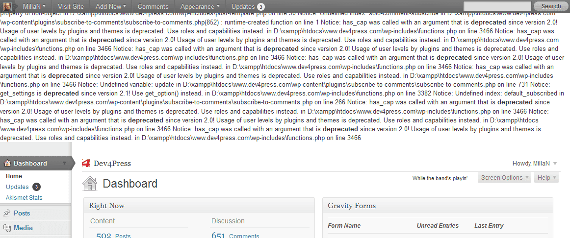

Yes, this all looks great. Enable WP Debug mode, and you will find the problem. And what if you find too many problems? Finding fatal errors is one thing, but enabling debug mode will open the door for all other error types to the surface, even if they are not critical. Look at the screenshot below, and you will see all sorts of errors: notices, deprecated use, and warnings. They are not critical, but when debug mode is on, you will see it all, making debugging almost impossible.
Debug Notices
Debug Notices printed on the page
Many plugins and themes (this can be applied to commercial ones) for WordPress will generate these non-critical errors when used. Some developers don’t care about these, and they will leave them in the code, and that points to another problem: if they didn’t care to fix these non-critical errors and warnings, what else in their code could be a real problem? As I said before, development should be done with debug mode, and these notices will be visible. If they left them in the code, they didn’t see them, which means they didn’t use debug mode. For my part, I try to fix every notice and warning I have in my plugins (even the most minor ones: initializing variables and arrays), and my plugins will not throw such notices (if you find any that I may have missed, please report it). This problem is further compounded by the introduction of PHP 8, and each new version has introduced deprecation changes and other things that have increased the number of notices and warnings displayed. It is essential to test all the code properly with both PHP 7 and PHP 8 and ensure those changes are incorporated correctly in the code.
So, you activate debug mode and find yourself drowning in the pool of notices all over the screen, and you have no idea where to begin. You can go through each plugin code to fix the problems, but that is not a good idea. Waiting for developers to fix their own plugins? Well, that can take a long time… After all this, debug mode can be tricky to use since it can be rendered useless when you have old and poorly maintained or poorly-written plugins in the first place. You can combine display and logging of errors, but for non-developers and less experienced users, debug mode can be impossible to use.

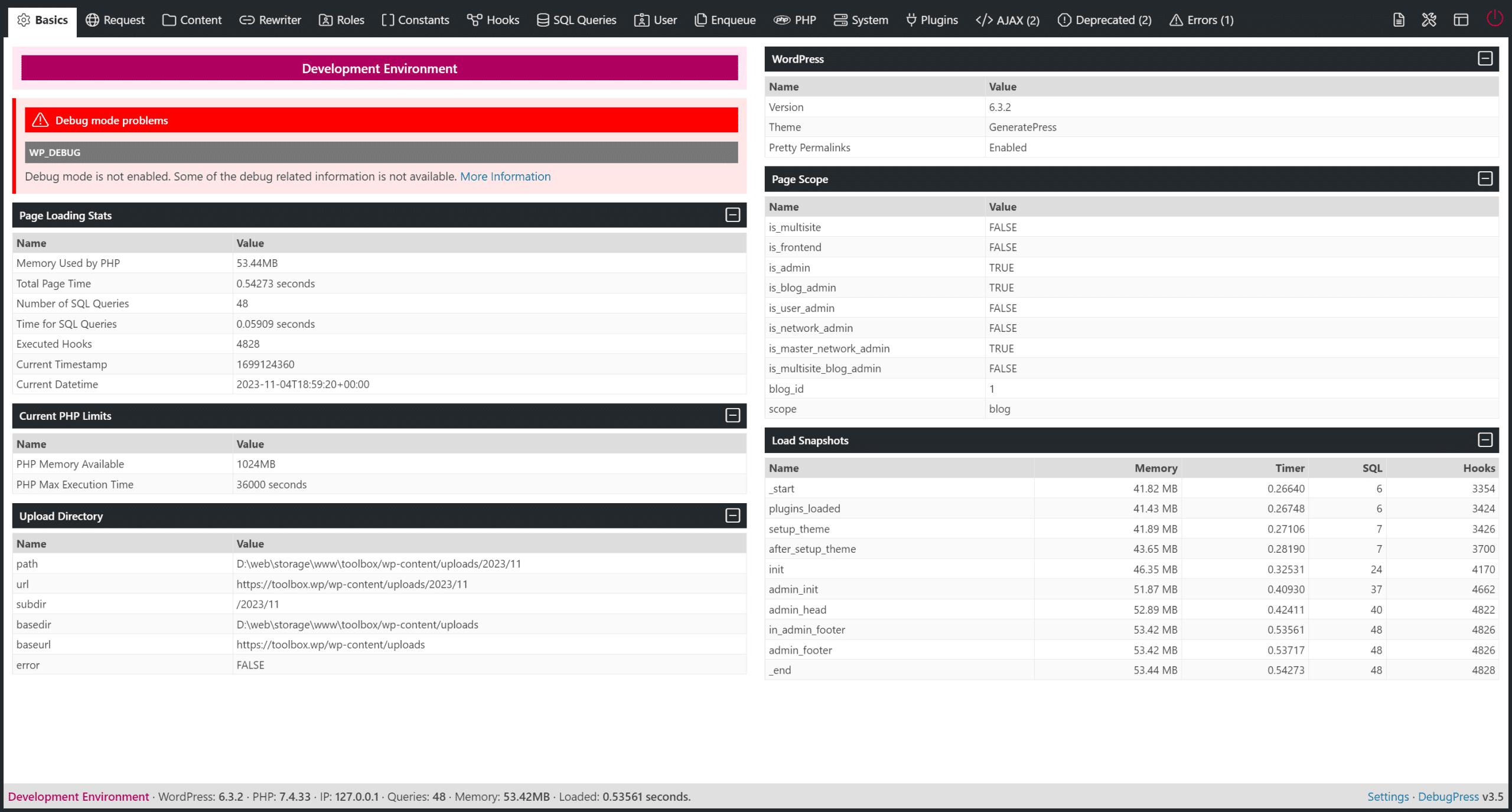

How do I use debug mode to display these error messages without messing with the page content? Thankfully, there is a way. PHP provides methods to override default error handlers and ‘hijack’ their output to hide it or use it for other purposes. You will not write your own handlers every time; the best is to use a plugin that will do that for you.
Since Dev4Press focuses on WordPress development, we needed a comprehensive and easy-to-use debugger. Dev4Press’s plugin, DebugPress, is free and available in the WordPress.org plugins repository.
debugpress 35
DebugPress Popup Debugger panel
The plugin debugger is activated through the green/yellow/red (depending on errors logged) bug button at the top of the screen (can be repositioned or placed in the admin bar). It can have many tabs with all sorts of data. All notices, warnings, and errors will be in the Errors tab; you can review it from there; no more mess in the page content.
