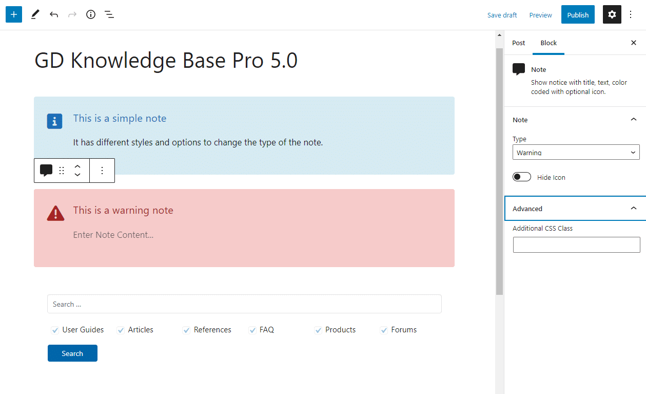

Some blocks I made
Eventually, I set aside time to start with blocks development, learn the basics related to set up, make the first simple blocks, use Server Side Rendering, and create the first few blocks. But, when it comes to more complex stuff, I had tons of questions on how to do things that I viewed as simple, but these things were not simple at all. My first issue was how to build controls for selecting posts or terms based on different criteria. And the issue of how to create complex block inspector control where things happen based on conditions. And the issue of working with data storage to get data back from the server. And, many more things you would expect to find simple examples because that is something everybody needs. But, no Gutenberg developer has had the time to make simple block examples, simple components that do these essential stuff to help other developers getting started and expand the developers’ base.

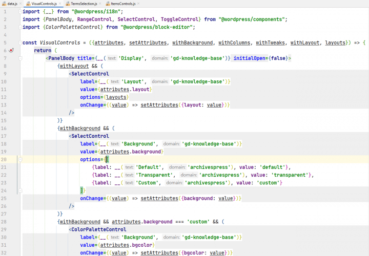

One of the controls I made to show different display elements for the block inspector
The majority of blocks I have made so far, rely on the use of the sidebar inspector and server-side rendering, but some blocks are fully done in JavaScript, with no need to get things rendered on the server-side. I even made several components for the inspector that I was reusing, several functions to run Entity Records queries, use custom SVG icons.
